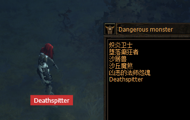

发表于 2022-4-15 15:16:01 | 显示全部楼层
J14Etc/GMT-8GMT-8000000202204151514166528.png
I tested it and everything was normal
You need to add the monster's English name or localized name (the selected HUD language)
Restart to make it take effect
